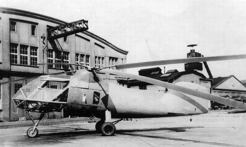

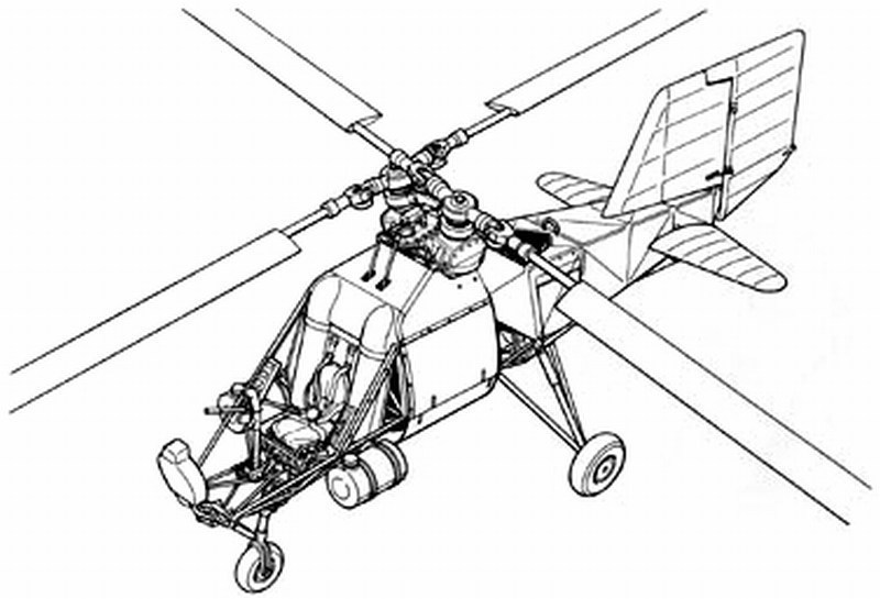

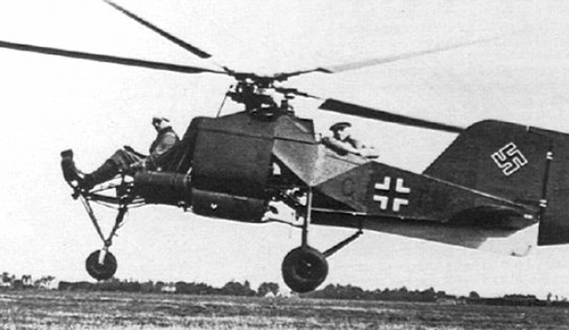

The Flettner Fl-282 Kolibri, a single seat open cockpit intermeshing rotor synchropter, was the World's first mass produced helicopter and the first helicopter to land on a ship. Today one can say without exaggeration that it was the best helicopter of its day. It was actually an improved version of the previously built Flettner Fl-265, a pioneering example of a synchropter with two intermeshing rotors. The exact date on which the RLM issued the development contract for the Fl-282 is not really known. It can be assumed with certainty, however, that design work was begun in 1939 while testing of the Fl-265 was under way. All the test results and experience from the previously built Fl-265 were applied to the design of the Fl-282. By mid-August 1941 work on the Fl 282 V1 had progressed to the point where it could be used on the ground as a transmission unit test bed. The test bed was anchored but could climb the length of the restraint to a certain height and hover. 125 hours and 39 minutes were spent in these tests, which lasted until November 21st 1941. In the event of the destruction of the V1 or a lengthy interruption of testing due to some other problem, it was planned to use the V4 as a replacement test bed. First free flight was made by the V2 on October 30th 1941. At the controls was test pilot Ludwig Hoffmann, who had joined Flettner as the successor to company pilot Perlia. Flight tests resumed in March 1942 following design changes to the cardan shaft; the tests revealed a significant improvement in the helicopter’s handling. The Fl-282 V2 was taken out of service on May 25th 1942; the aircraft's transmission & engine were removed for use in other prototypes. Test pilot Ludwig Hoffmann carried out two altitude flights in the Fl-282 V3 on April 27th 1942. On the first he reached a height of 3500 meters over the takeoff point and on the second attempt 3800 meters in 36 minutes (from 15:17 to 16:10 hours).

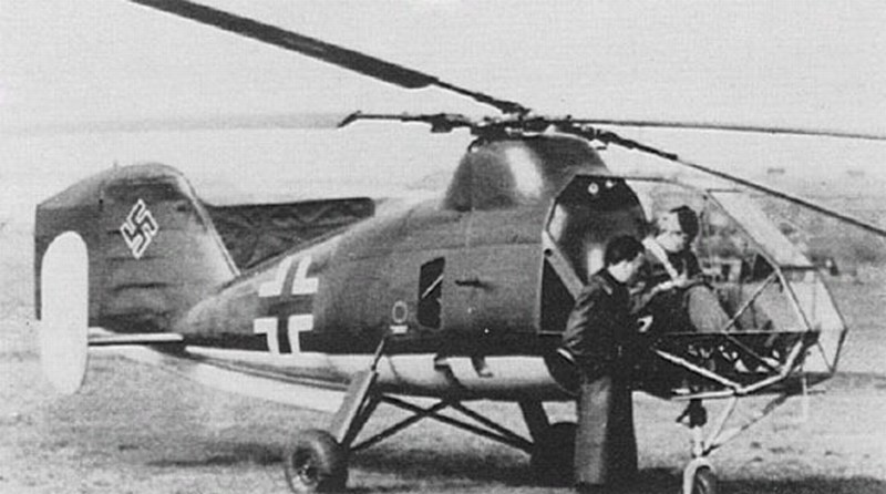

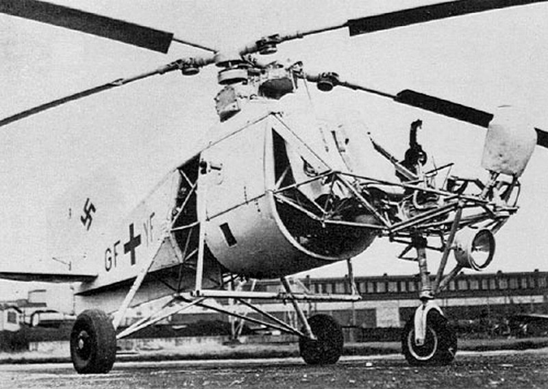

In following pictures, the Fl-282 prototype helicopters. The V2 (registered as GF-YB) with fully glazed cockpit, completed its first flight on October 30th 1941 and the V3 (registered as GF-YC) had “H†shaped horizontal stabilizers with end plates. The first three prototypes (“A†series) had fully enclosed cabins made up of a series of optically flat plexiglass panels, faired-in rotor pylons and well-contoured fuselages. The V3 version was fitted with endplate auxiliary fins and a long underfin beneath the rear fuselage. Later machines had more utilitarian bodies. Some ("B-0" series) had a completely open pilot's seat, some ("B-1" series) had semi-enclosed cockpits by flat plexiglass panels and finally some others ("B-2" series) had cockpits enclosed by combination of plexiglass & wooden sidewalls.

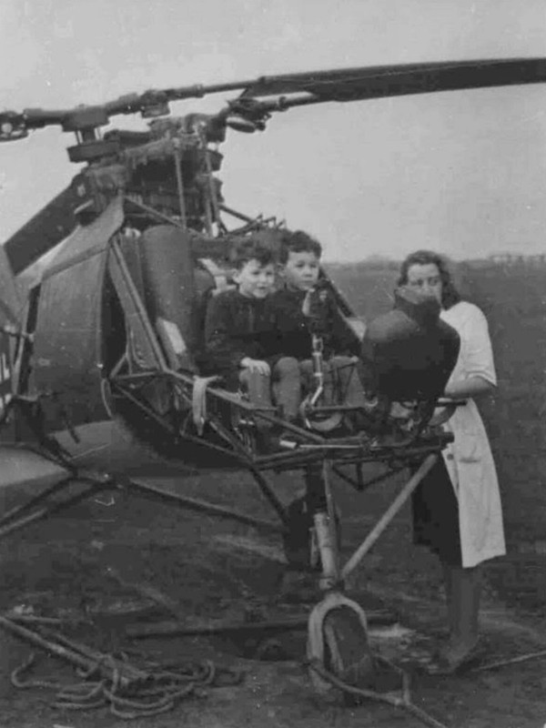

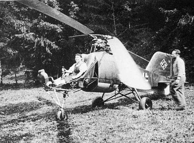

The idea of the helicopter was new at that time and Anton Flettner and his team made a lot of efforts to convince the German Air Ministry that it’s a good product. One of these efforts was to take an average German housewife and teach her to fly the new helicopter. As seen into following photograph, they finally proved that the vehicle was extremely stable and very easy to fly. So easy, that an average German housewife with no previous flying experience, managed to control the Fl-282 V22 (registered as CI-TV) helicopter, after only 3 hours of flight training.

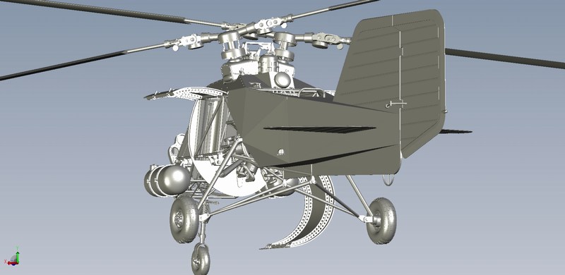

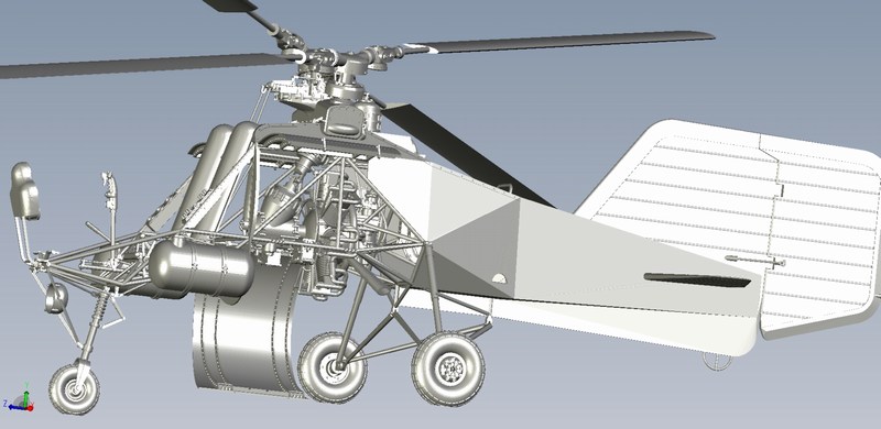

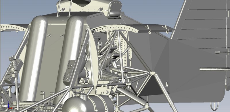

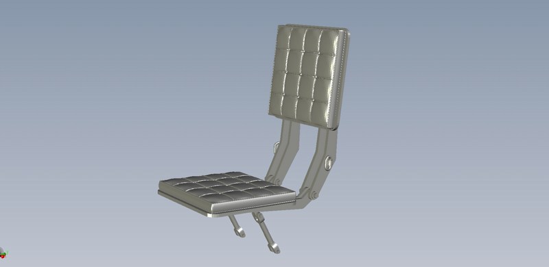

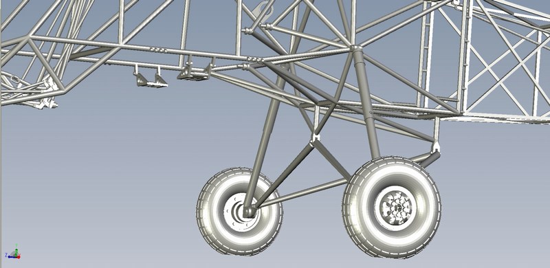

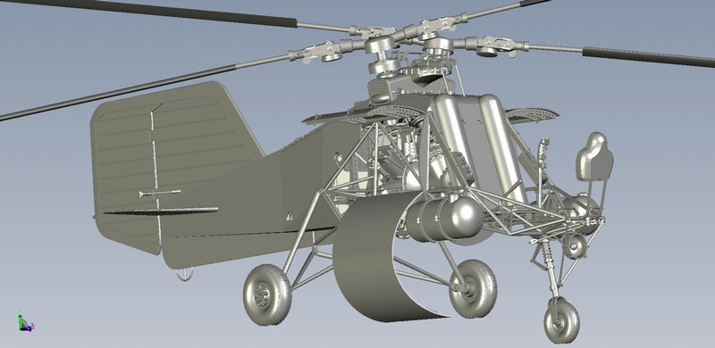

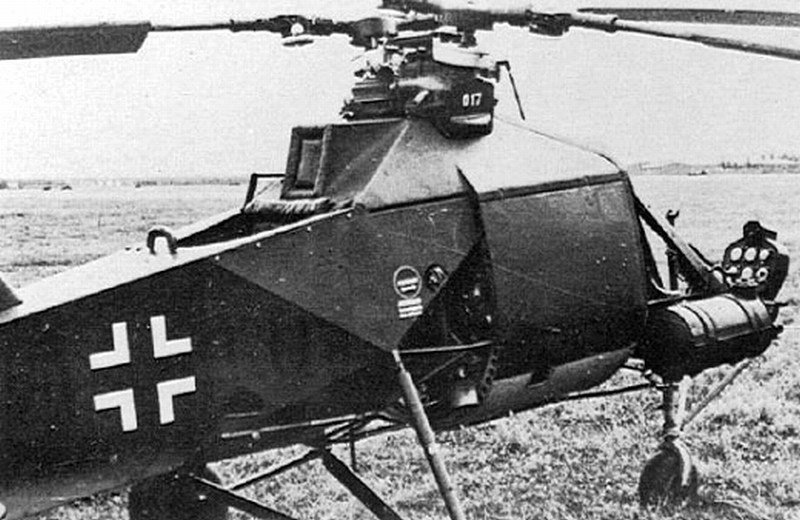

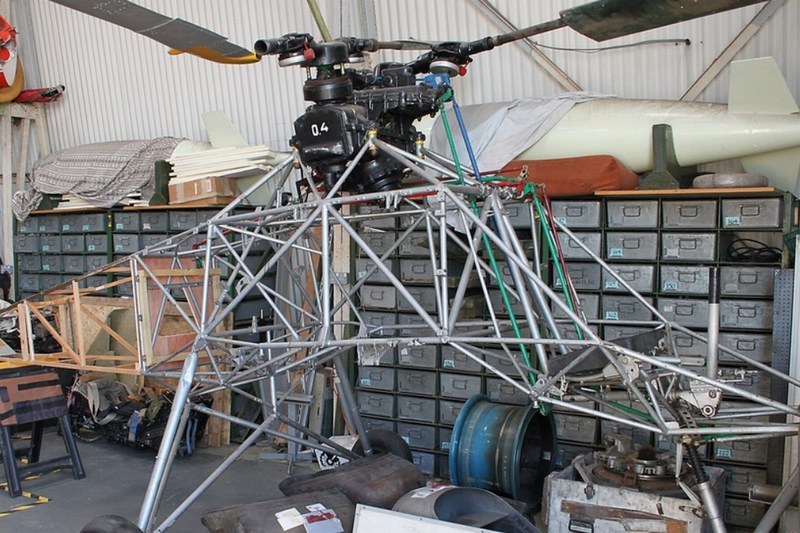

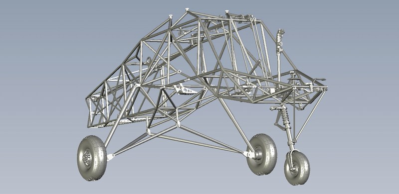

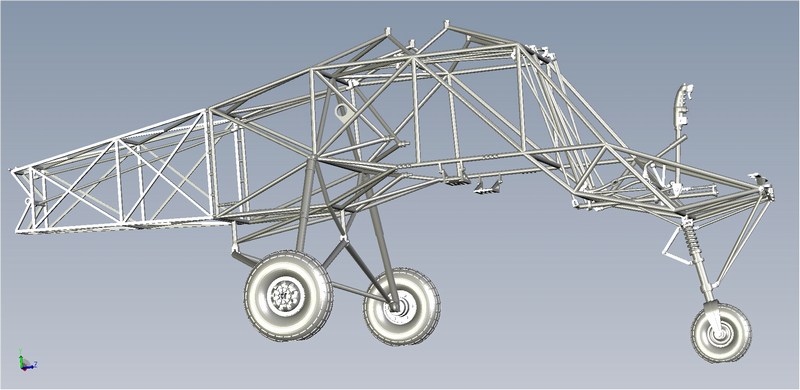

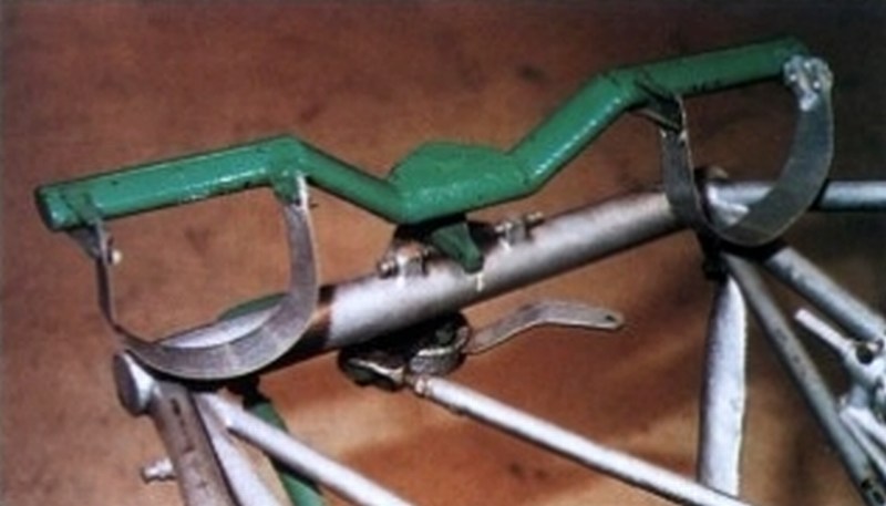

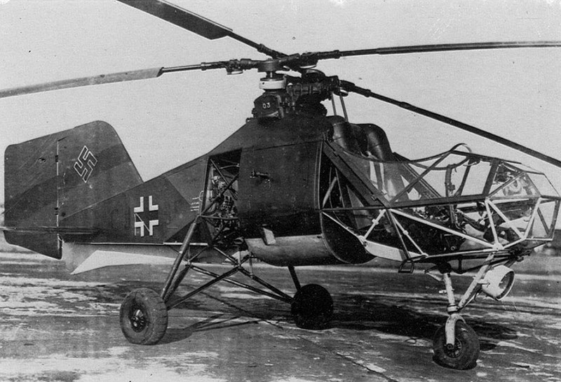

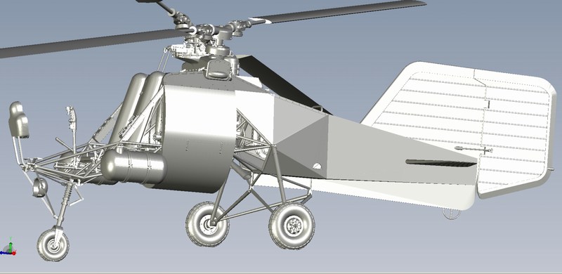

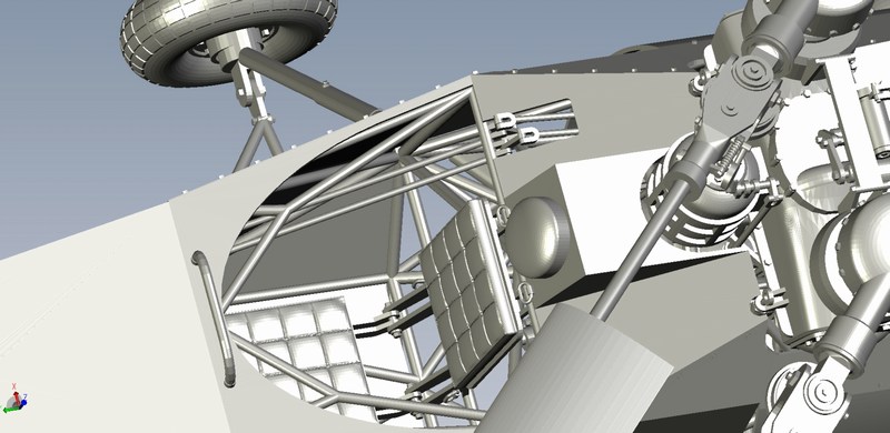

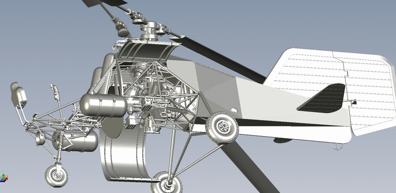

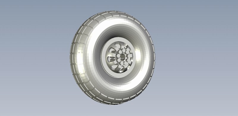

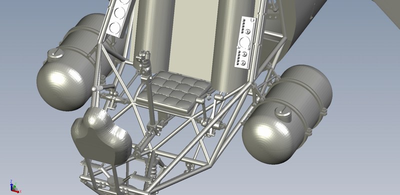

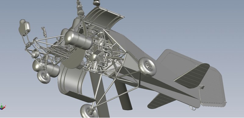

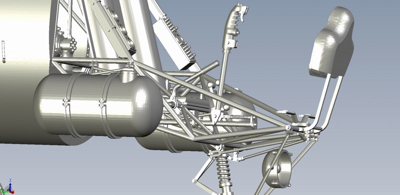

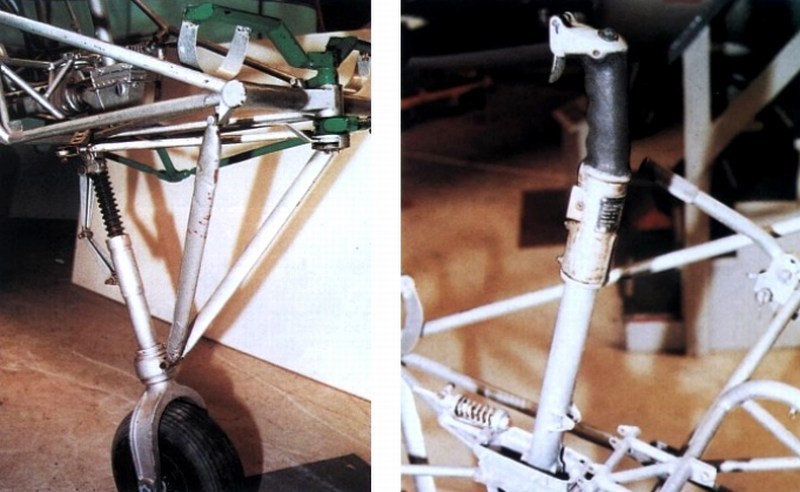

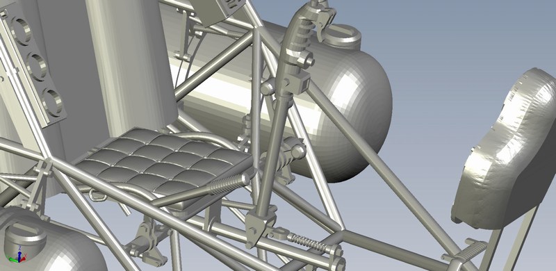

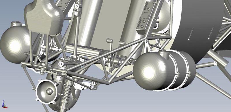

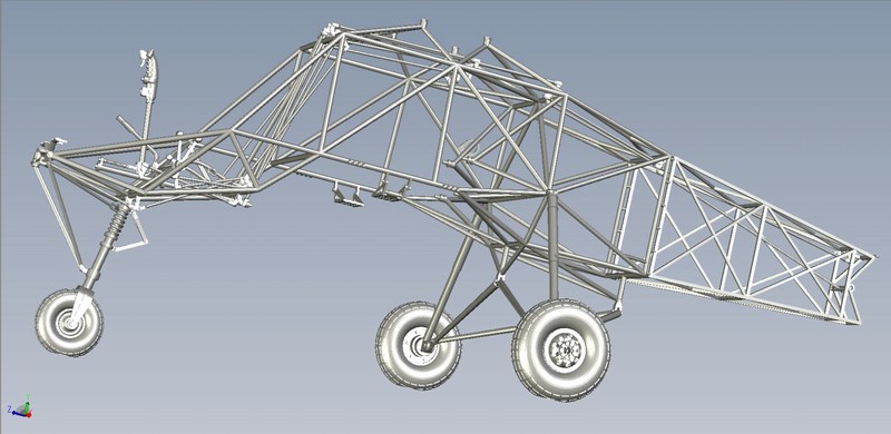

The fuselage was constructed from truss-type welded steel tube, covered with doped fabric. It was fitted with a fixed non-retractable tricycle type undercarriage, with the braced fixed nose wheel with VDM oil shock absorber leg coupled with the rudder foot pedals for steering. Nose wheel was equipped with a 350x150 mm tire and main gear with 465x165 mm tires. The rectangular outline with rounded tips rotor blades were made by tubular steel spar with riveted-on wooden ribs and plywood skin with fabric covering and axes of both rotors were angled outboard at 12° from the vertical. Seen from above, the right rotor rotates clockwise and the left rotor counter clockwise. At the rear end of the fuselage, a two-part horizontal stabilizer with single spar was provided for trimming purposes and a rudder fin of very generous area. This large area was necessary because much of it was ineffective due to the poor aerodynamic shape of the fuselage causing rearwards flow separation and turbulence. It was constructed by tubular steel spar with riveted-on wooden ribs, plywood leading edge & fabric-covered. Steering of the Fl-282 was by a combination of the rudder and differential collective pitch change on the two rotors, but only the rudder could give steering during autorotation since collective pitch was then ineffective (another reason for the large rudder area). Rudder fin was made of wood and covered by fabric, with 40° deflection. The vertical stabilizer and the elevators were also made of wood, with plywood leading edge and fabric covering, bolted to fuselage frame.

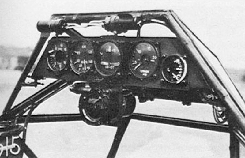

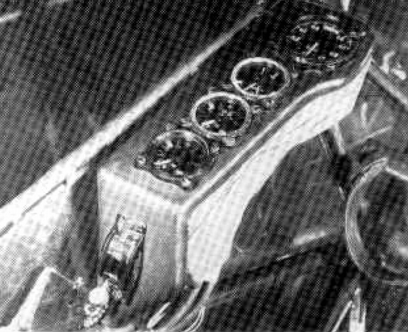

It was equipped with flight and navigation instruments such as an ASI - AirSpeed Indicator, an altimeter, a VSI - Vertical Speed Indicator, a turn & bank indicator, RPM indicator for rotors, rotor blade angle indicator, a master compass and a dashboard clock. Radio & signalling equipment consisted of a FuG 19 ultra short wave radio installation. Back type parachute, first aid kit, signal flare pistol and one-man inflatable raft were also present. In following pictures, the instrument panel of the first three prototype helicopters with fully enclosed cabins made up of a series of optically flat plexiglass panels.

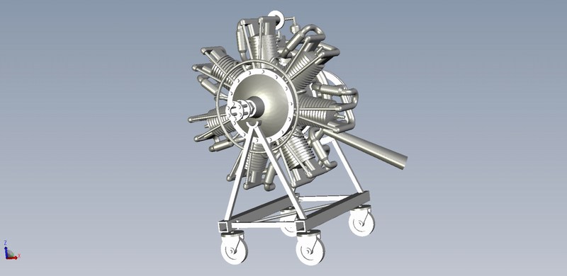

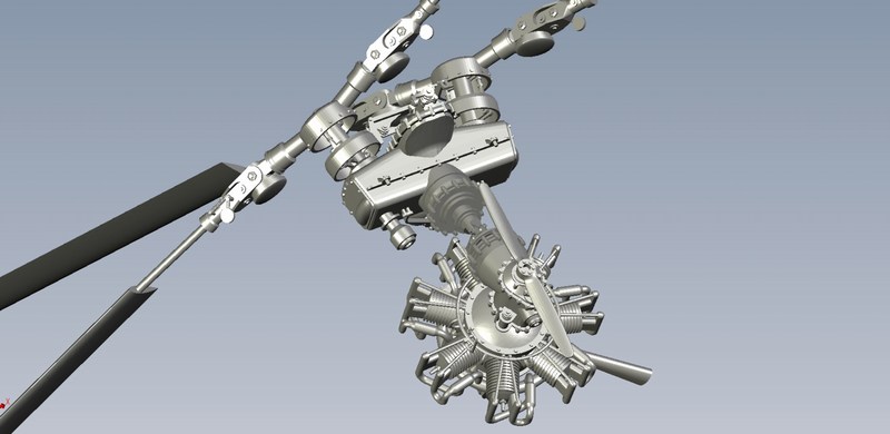

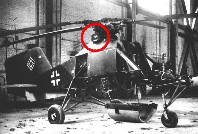

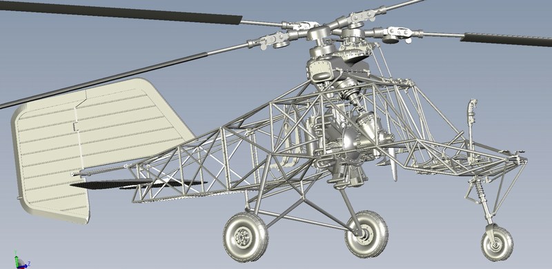

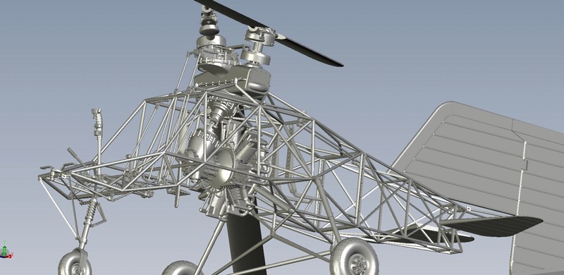

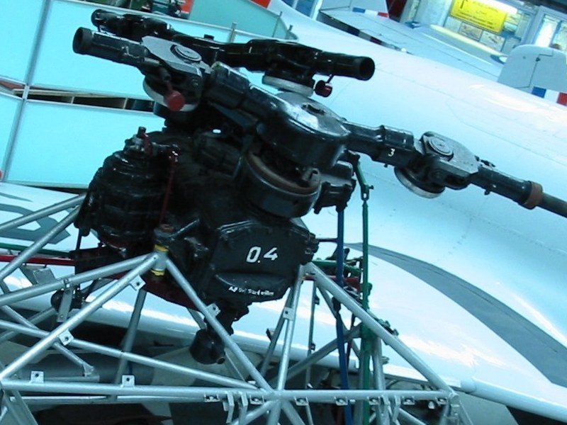

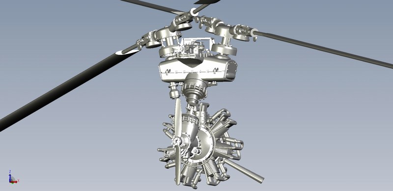

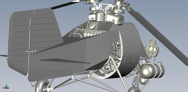

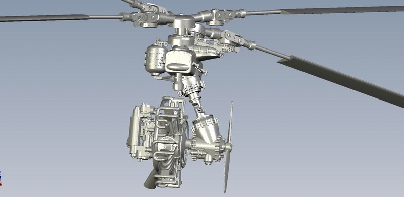

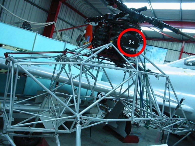

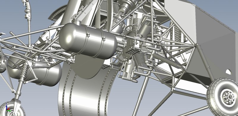

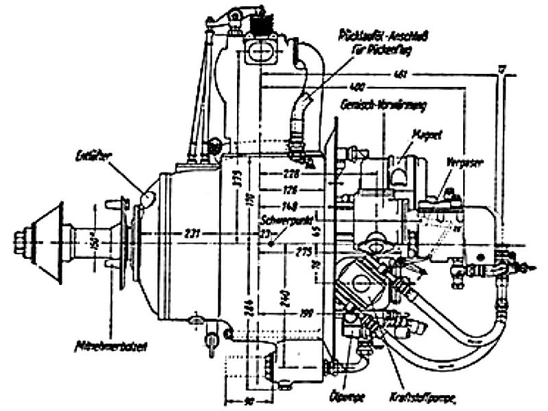

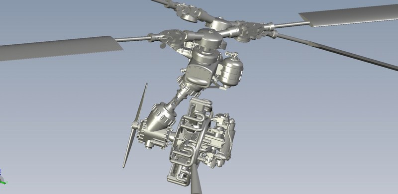

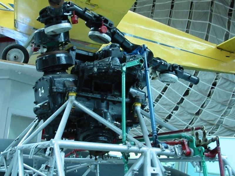

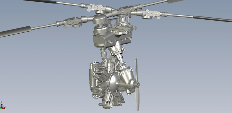

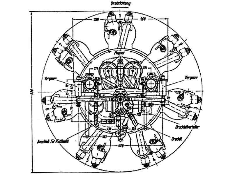

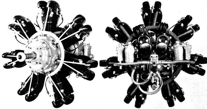

The Flettner Fl-282 Kolibri was equipped with a Bramo Siemens Halske SH-14A, 7-cylinders radial engine of 119 kW (160 hp) mounted in the center of the fuselage, with a transmission unit on the front of the engine from which a drive shaft ran to an upper gearbox, which then split the power to a pair of opposite drive shafts to turn the rotors. The SH-14A was an already tried engine design that only required servicing every 400 operating hours.

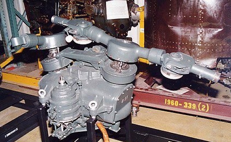

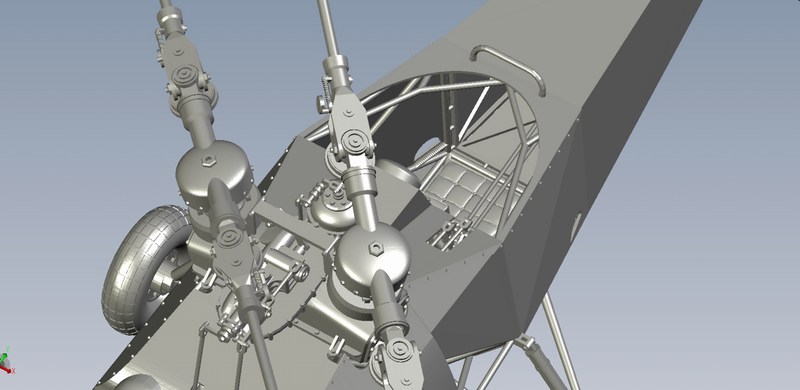

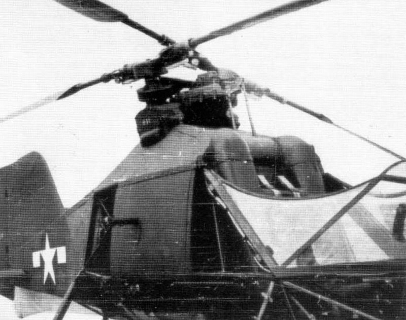

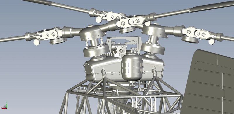

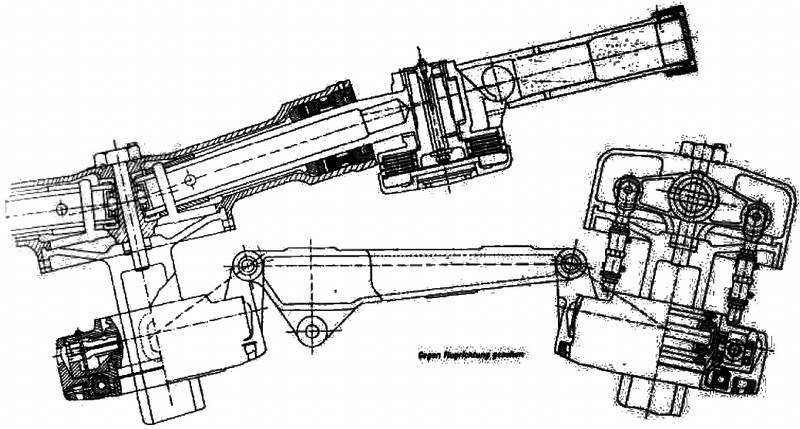

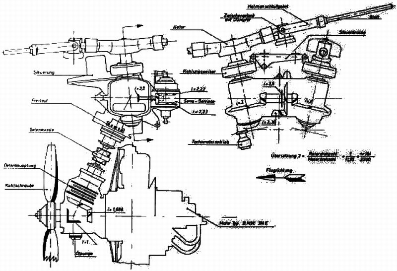

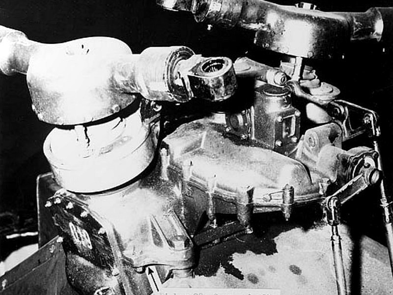

A drive shaft with universal joints took the drive from the engine transmission unit to the upper transmission unit, which consisted of gears and shafts connecting the two rotor shafts. The final cross-shaft between the two rotor shafts was fitted with a free wheeling unit to disconnect the engine drive, and also with a rotor brake. On the drive-shaft from the engine, a friction disc clutch was fitted which was used for running up the rotors until there was no slippage, when a positive dog-type clutch, on the same shaft, was then engaged. Total reduction through all the transmission units was 12.2 to 1. Cooling air for the enclosed engine was drawn in through openings beneath the fuselage by an eight blade wooden cooling fan with direct drive from the engine and a high pressure air tank was connected to the engine cylinders through a distributor for starting.
The two 2-blade rotors, which were synchronized to be parallel in the 45° position, were mounted on shafts having an included angle of 24° between them and an inclination forward of 6°. The rotor blades consisted of wooden ribs mounted on tubular steel spars with a covering of plywood followed by fabric. Flapping and dragging hinges were fitted, the latter having friction dampers. A centrifugally operated blade pitch governor held the rotor rpm within prescribed limits, the governor being driven through clutches from the rotor transmission. In order to ensure that power-off autorotation was not lost, the governor was set for a minimum rotor speed of 160 rpm. With the use of his collective pitch lever, the pilot could over ride the governor but only to increase rpm. Under certain conditions, self-excited oscillations could occur in the rotor; this happened in flight on one occasion when an Fl-282 was being flown with a high collective pitch and the low rotor speed of 140 rpm (compared with the recommended 175 rpm). Vibration became so severe that the pilot prepared to bail out, but, before he could do so, the machine went into autorotation and the vibration ceased.

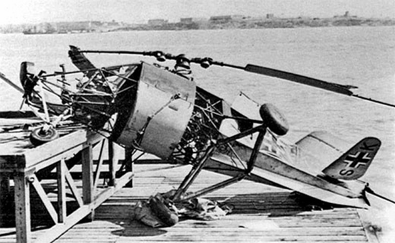

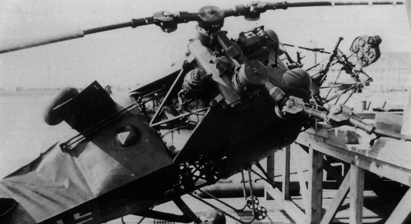

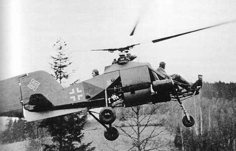

As seen into following two photographs, the CJ-SK registered Fl-282 V17 helicopter, following a crash-landing at Travemünde, on April 13rd 1944, with test pilot FliegerStabsingenieur (Luftwaffe Major) Gerhard Geike behind controls who replaced the main test pilot Fliegerstabsingenieur Dipl. Ins. Hans Fischer after he was badly hurt in a Dornier Do-217 crash.

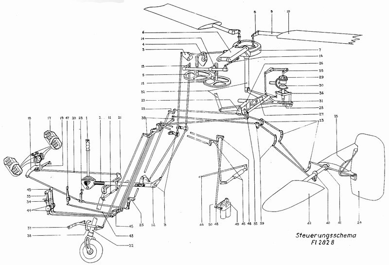

Extremely manoeuvrable and very stable, even in gusty conditions, the machine could be flown hands-off in forward flight above 60 km/h for indefinite periods by making an adjustment to neutralize the loads on the controls. However, in forward flight at speeds below 60 km/h there was some longitudinal instability, which reached a maximum at about 40km/h. Another slight criticism of the Fl-282 was that it vibrated rather badly while the rotor was running up on the ground, but this vibration decreased upon lifting off, although there was still a certain amount of vibration transmitted to the control column, which was sluggish and tended to overshoot the requisite amount of movement. Although many of the mechanical components were unnecessarily complicated and heavy, the general design and workmanship were of excellent quality.

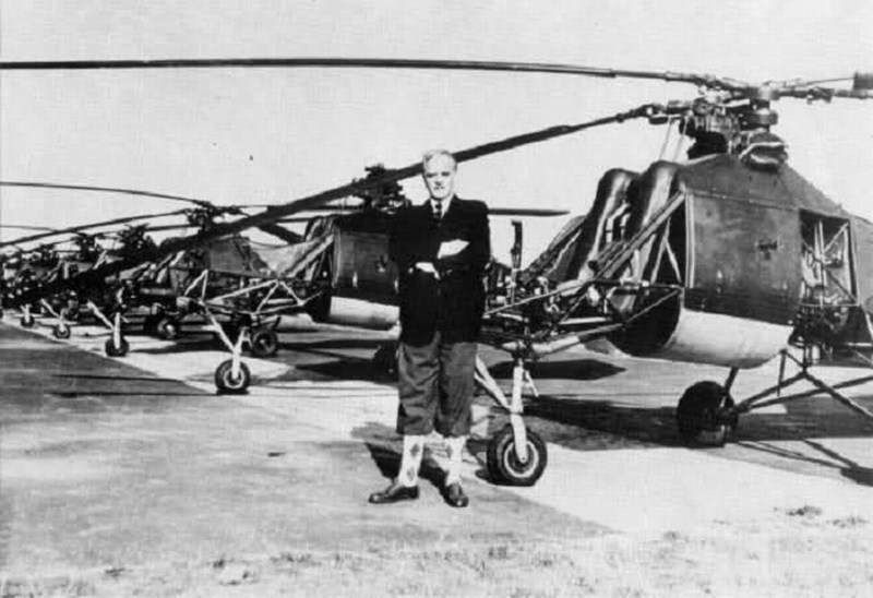

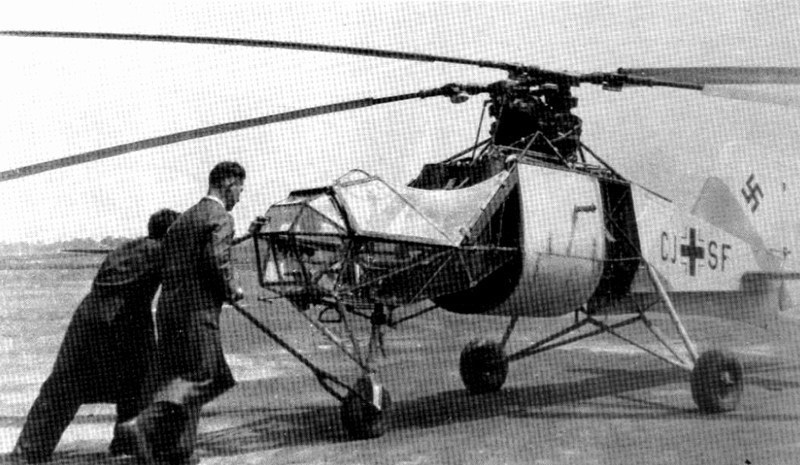

Since taxiing under its own power was strictly forbidden, the Fl-282 V12 registered as CJ-SF seen in following picture, pushed back by ground personnel. This rule imposed because the non vertical angled rotor hubs resulted in the blade tips at the sides of the craft being around human body height and made the craft dangerous to approach from the ground whilst the blades were spinning. In addition, the blades could be damage by contact with the ground. At heliports these two problems could be overcome, but at unprotected sites this would be a concern. So, they had a simple rule that ground crew could not approach at that time or only directly from the front.

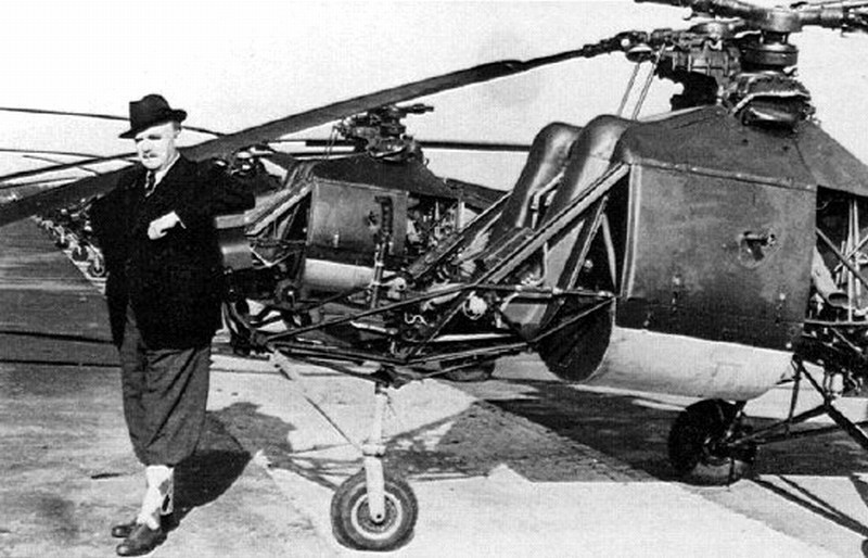

In following picture, Emil Arnolt (left) chief designer at Anton Flettner Flugzeugbau GmbH, test pilot Oberleutnant (Luftwaffe 1st Lieutenant) Hans E. Fuisting and a mechanic (name unknown), in front of company’s factory plant. Next photograph, Emil Arnolt’s family (wife & kids) having their first contact with the new helicopter. Pictures provided by Carsten Arnolt, grandson of Emil Arnolt.

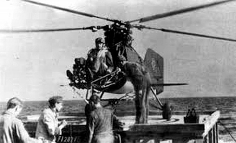

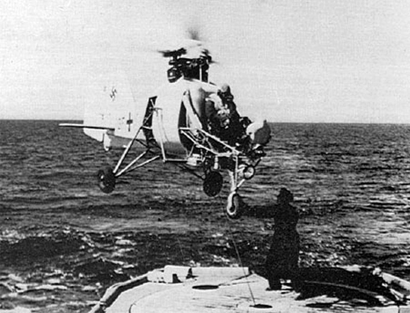

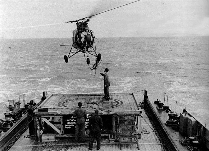

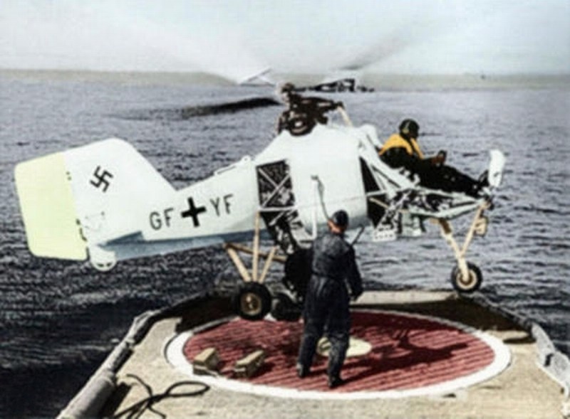

On September 1942 a Fl-282 Kolibri V12 version with registration CJ-SF, was initially tested by Anton Flettner's chief pilot Oberleutnant (Luftwaffe 1st Lieutenant) Hans E. Fuisting, aboard the Kriegsmarine's ship “Greif'â€, a 2000 ton aircraft salvage ship. Few weeks later, in October 1942, another two Fl-282 helicopters, one V6 version with registration GF-YF and one V10 version with CJ-SD registration, were delivered to Trieste with their personnel, including Hauptmann (Luftwaffe Captain) Klaus von Winterfeldt, Anton Flettner's chief pilot Oberleutnant (Luftwaffe 1st Lieutenant) Hans E. Fuisting and a 3rd pilot (his name & rank are unknown) plus three mechanics for technical support. From November 1942 until February 1943, the Fl-282 V6 registered as GF-YF, had been extensively tested aboard the Kriegsmarine's minelayer “Drach†(“Schiff 50â€, ex-Yugoslavian “Zmajâ€) while operating in Aegean Sea, north of Crete, Greece, following the absence of RAF aircrafts in the area for few months. The second V10 Kolibri registered as CJ-SD, was a reserve machine that stayed ashore.

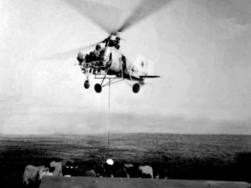

The helicopter was operated from a 15 m² wide platform pad, while the ship was moving. It was no simple matter setting a helicopter down on the waving deck of a ship, so a special system was designed to bring the two vehicles together. A 10 meters long cable was attached to a swiveling fixture on the bottom of the helicopter. The pilot would bring the helicopter in to hover just out of ground effect over the platform and release the free end of the cable. Two men on the deck would grab the cable and hook it onto the winch drum, pulling the helicopter down to the deck. While this was going on the pilot applied enough power to keep the cable taunt, thus the helicopter took the waves in unison with the ship. The reverse procedure would be performed for take-off. A similar method is still used today for operating helicopters off of ships in rough weather.

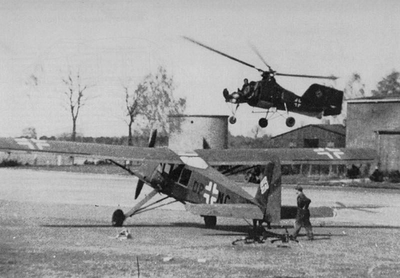

By 1943, the Fl-282s were routinely being used by the Kriegsmarine for convoy protection and reconnaissance. Usually they flew from platforms above the gun turrets of convoy escort vessels in the Aegean, Baltic and Mediterranean Seas, often in extreme weather conditions. The Flettner Fl-282s revealed control & performance qualities well above expectations and found to be especially valuable at dawn or dusk when fixed wing aircraft pilots did not have good visual contact in the poor light. As an important area of operations, the Mediterranean Sea offered the promise of worthwhile missions for the Kolibri and the tactical trials could be conducted into the most favourable weather conditions. As well, the U-617 submarine was also available to participate to the trials. During the day, helicopter crews could spot the submarine as deep as 130 ft. Once a sub was spotted the Kolibri could easily match the speed & course of the submarine, which was impossible for the fixed wing aircraft with stall speeds higher than the cruise speed of a submarine. The Fl-282 would then radio transmit the sub's position to the convoy and if a warship was dispatched to attack on sub, the helicopter would mark the target's position with a magnesium flash bomb or marker flares. The V9 helicopter registered as CJ-SC was the prototype for a version to be operated by the Navy from large submarines and designated as Fl-282 U (Umbau) “Modified Model in Form of a Standing Cylinder†version. Although the Fl-282 was designed so the rotor blades and landing gear could be removed and the helicopter stored in a compact area such as the pressure tank of a U-boat, there is no evidence that it was ever used this way.

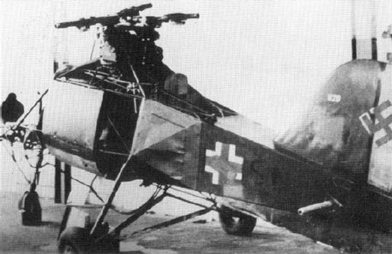

However, as the War progressed, the Luftwaffe began considering converting the Kolibri for battlefield use. Until this time the helicopter had been flown by a single pilot, but by then a seat for an observer was added at the very rear of the craft, resulting in the V21 and later the V23 reconnaissance liaison versions with two seats for pilot and observer. These helicopters later proved a useful tool on multiple roles, used for picking up downed airmen, artillery spotting and other observation duties. It was similar to the naval helicopter, but a rearwards facing seat for the observer was positioned behind the rotor shafts. This made necessary the removal of the main fuselage fuel tank with consumable content 105 litres of 87-octane aviation gasoline. The standard fuel tank was removed and replaced by two un-protected, 25 litres cylindrical fuel tanks mounted externally on both sides of the pilot seat. The FuG 19 ultra short wave radio installation of the naval version was also replaced with a smaller and lighter short range radio. The naval version’s one-man inflatable raft, the single-barrel flare pistol, the hand operated signal lamp and other sea survival equipment were also removed. Beginning in 1944, the Luftwaffe began to implement a program to provide a helicopter to each Wehrmacht’s independent artillery brigade.

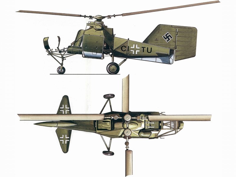

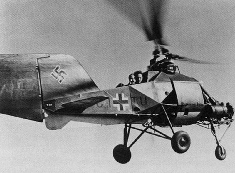

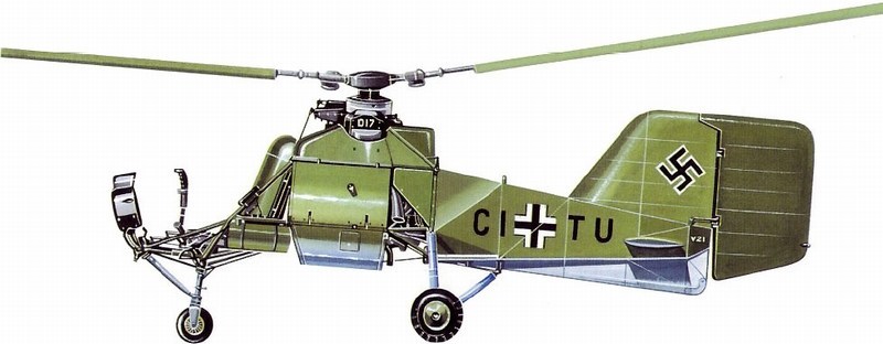

The twin seat Fl-282 V21 helicopter registered as CI-TU, as seen while been tested with two men in rear compartment plus pilot. Anton Flettner himself took part on these test flights sitting in the rear observer’s seat and company chief pilot Oberleutnant (Luftwaffe 1st Lieutenant) Hans E. Fuisting on the flight controls.

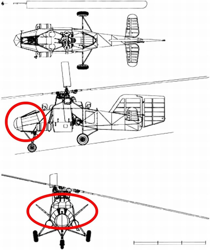

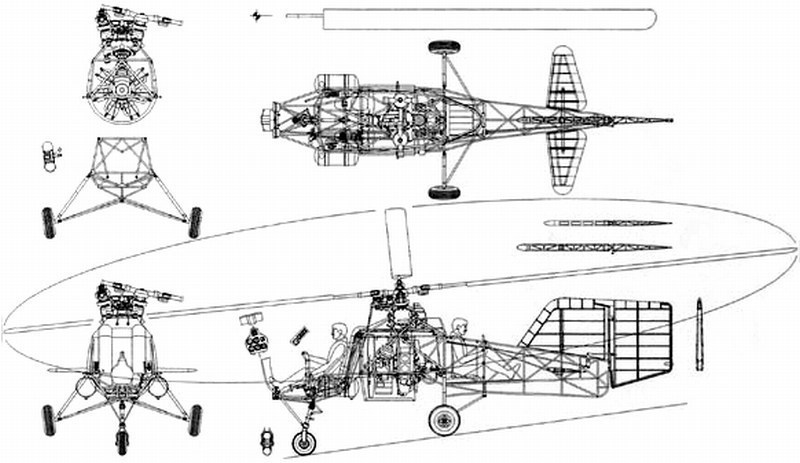

The V23 version had also two seats for pilot & observer, but differed from V21 because it was equipped with V-shaped stabilizer (similar to that of the Cierva C-30) and also had wooden cockpit sidewalls, as visible into following diagram.

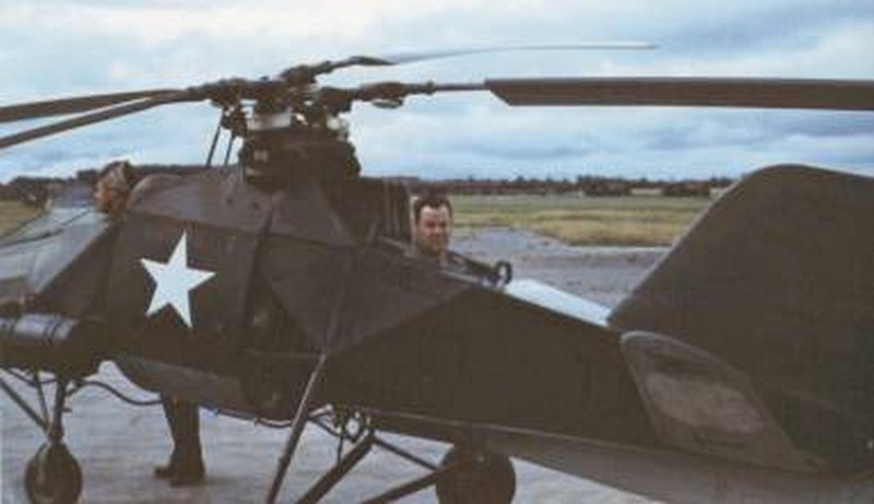

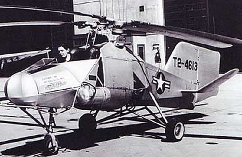

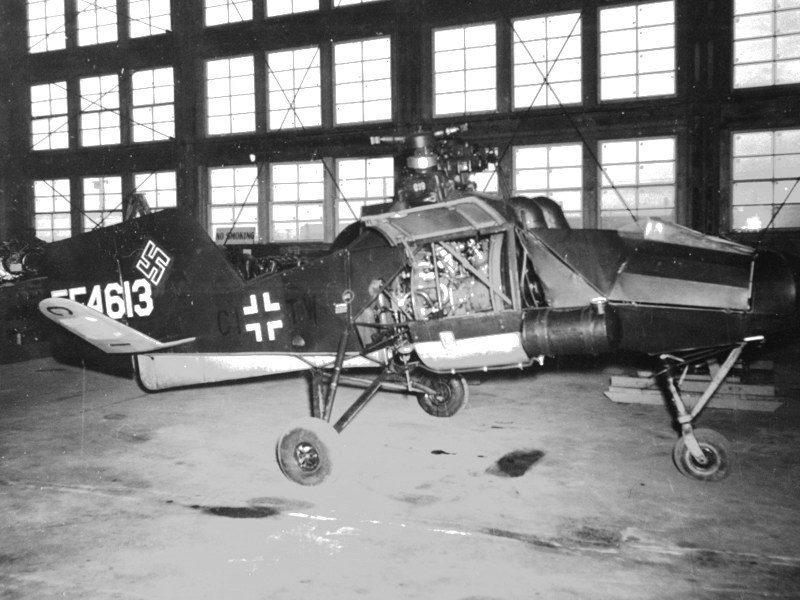

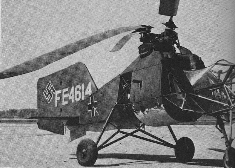

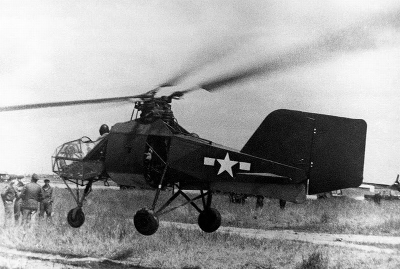

Captured helicopters #1 & #2: The first two flyable helicopters were found intact by US Army troops. One V23 helicopter registered as CI-TW and one V15 registered as CJ-SI. These two Fl-282s, received the FE-4613 and FE-4614 US numbers after been captured and transported from Cherbourg Octeville, France to Newark New Jersey, USA (Operation “Seahorse†from July 12nd 1945 to July 19th 1945) aboard HMS “Reaper†D82 (a “Bogue†class escort aircraft carrier of US Navy, leased to the Royal Navy during WWII) for further investigation. The Fl-282 V23 Kolibri was a two-seater similar to the V21, with V-shaped stabilizer fins. Into following pictures, notice the exact same V23 helicopter as seen with pre-capture Luftwaffe’s CI-TW registration & swastika markings and later in USAAF service with the FE-4613 US numbers visible, after been captured.
These two Fl-282s found & captured by the US Army troops were actually revealed by Anton Flettner himself. These two helicopters were flown from Schweidnitz to Bad Tölz, few days earlier, on April 26th 1945. The first (CI-TW registered V23) flown by company’s chief pilot Oberleutnant (Luftwaffe 1st Lieutenant) Hans E. Fuisting, was hidden in a barn near Bad Tölz. The other (CJ-SI registered V15) helicopter flown by pilot Ernst Remain, was hidden in a mill near Penzburg, 15 km west of Bad Tölz. Following the arrival of the US Army forces, Anton Flettner reported the hiding places to the US military administration in Bad Tölz. The two US held Fl-282s were first taken to Munich and then to Stuttgart (Nellingen flugplatz) where been demonstrated to Allied officers by German pilots. Since USAAF officers were impressed with the helicopters, the captured Fl-282 V23 (CI-TW / FE-4613 registered) Kolibri transferred to St. Dizier, France on June 15th 1945 and been demonstrated by Anton Flettner’s chief pilot Oberleutnant (Luftwaffe 1st Lieutenant) Hans E. Fuisting. By December 1945, the Air Technical Intelligence collection and evaluation process for Luftwaffe technology officially transferred from London, UK to Wilbur Wright Field (officially “Area B†of Wright Patterson AFB) near Riverside Ohio, USA.

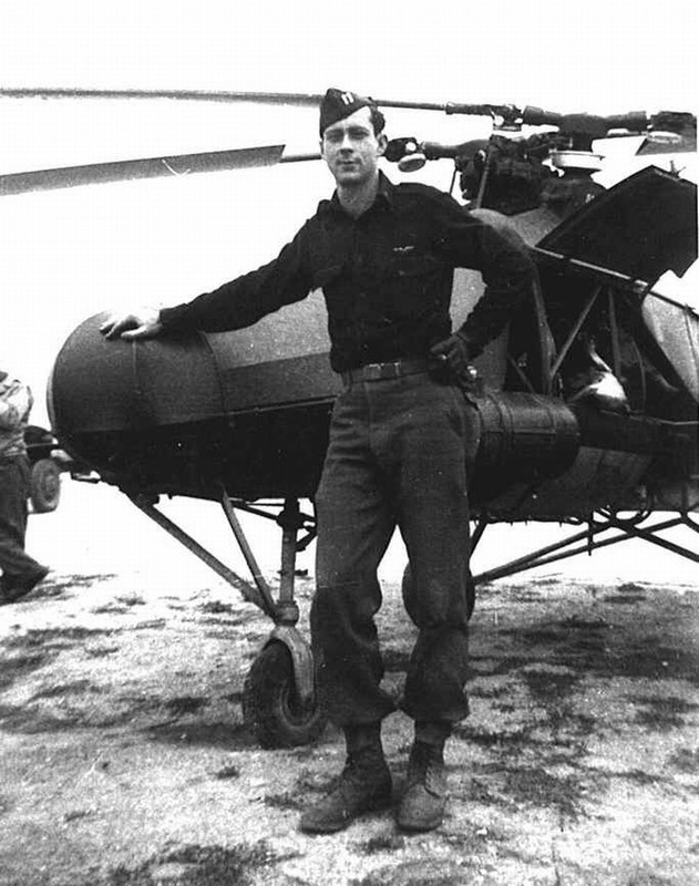

The evaluation flights in US (115 hours) were conducted at Benedict airport, Booth Corners Pennsylvania, USA by Prewitt Aircraft company test pilot Captain Dave Driskill. The objectives of the tests were to determine power requirements, control response, stability measurements & a comparison between a straight and a V-shaped stabilizer. In March 1946, the Air Technical Service Command became Air Material Command and it was around this time the “FE†numbers, assigned to captured Luftwaffe aircrafts, became “T2†being the organization designator for Air Technical Intelligence. The prefix "FE" (meaning Foreign Equipment) changed to "T2" but the inventory numbers did not change. This probably reflected the organizational changes taking place. Now days, the Fl-282 V15 is presented at the Cranfleld Institute of Technology. On the other hand, although the V23 helicopter was transported and placed at the

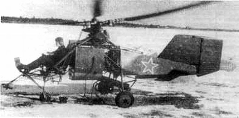

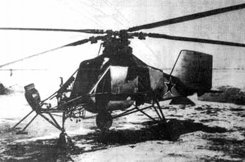

Captured helicopter #4: It is reported that another Fl-282 helicopter which had been assigned to TransportStaffel TS40 was captured at Rangsdorf by Red Army forces in serviceable condition and later transferred to USSR for further testing & evaluation. Judging by the following pictures, it’s a B-0 series (without partial plexiglass enclosure of the cockpit), single seat helicopter and could possibly be the V13 (CJ-SG registered) or the V14 (CJ-SH registered) or the V16 (CJ-SI registered) or the V18 (CJ-SL registered) helicopter. The first two helicopters should be excluded because Luftvaffe’s files reveal that the V13 & V14 were both unserviceable & grounded that time (V13’s rear fuselage and V14’s rotors removed to be used as spare parts on other helicopters). This means that the pictured Soviet captured Kolibri might was the V16 or the V18 helicopter (both previously assigned to Staffel 1/196 at Pillau AB and Grouppe 3/196 at Kiel). Another possible answer for the mysterious helicopter could be the V11 (registered as CJ-SE) property of Anton Flettner Flugzeugbau GmbH company and used as testbed, later transferred to TransportStaffel TS40 stationed at Rangsdorf AB, but it was also reported to be grounded because had no engine installed that time. On the other hand, there is a possibility that the helicopter appeared to be captured by Soviets, could be a B-1 series machine, for example the V12 (CJ-SF registered) helicopter survived until the end of WWII, with the cockpit glazing removed by Soviets later. Keep in mind that the V16 helicopter was also considered as the Soviet captured Kolibri by RS Models, also pictured on their 1/72 scale “Flettner FL-282 B-0 Kolibri†model (company’s code
92083) instructions sheet. According to RS Models, the V16 was transferred to Sukovskoje, USSR and evaluated until 1947. Anyway, since no more info is available about the Soviet held Fl-282 helicopter’s fate after the WWII, we cannot be absolutely sure for a positive ID.

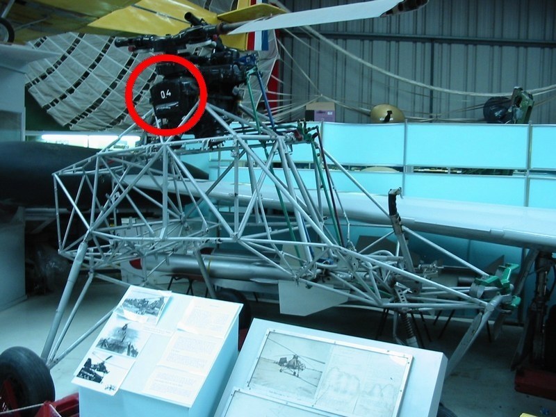

Captured helicopter #5: Finally, a fifth Fl-282 V20 helicopter (registered as CJ-SN) previously assigned to Staffel 1/196 at Pillau AB, found & captured by the British Army in good condition. For some unexplained reason, the helicopter been brutally disassembled and some parts of it ended up as souvenirs. The doped fabric ripped away & removed from fuselage, the horizontal stabilizer fins mysteriously stolen, the clipped rotor blades cut off and are never seen again since that day. The remaining framework wreckage with upper rotor transmission, transferred back to UK as a War trophy, on late May 1945. Notice the “04†which indicates the serial number of the upper rotor transmission as pictured right after been found and next photographs as finally disassembled & transferred on a truck by British troops as War trophy. Upon arrival in UK, this exact helicopter Fl-282 V20 relic became property of the Cranfield College of Aeronautics until mid 1960ies, when sold to Midland Air Museum. Now days, the captured V20 helicopter fuselage framework parts with upper rotor transmission and what left of the chopped (once full-length) rotor blades, are presented at the
Midland Air Museum situated just outside the Baginton village in Warwickshire, UK and is adjacent to Coventry, UK airport. Unfortunately, many parts are still missing and the doped fabric cover & rotor blades never been restored.
